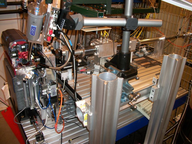

We determined that repeated insertion/retraction of the cold stream was causing the sample camera to drift out of alignment over time. A new support for the cryojet was built to isolate it from the other beamline components, improving camera stability.
Photo.
